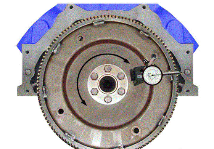

Since this has been a reoccurring issue, excessive crankshaft flange run-out or end play is likely the cause. In most cases, this can occur in worn engines or engines that have been poorly rebuilt. On the other hand, if at any time the transmission was dropped or the torque converter was dropped, it can cause a misalignment.

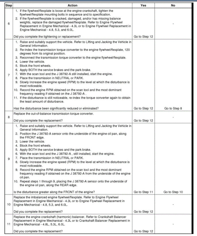

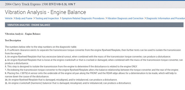

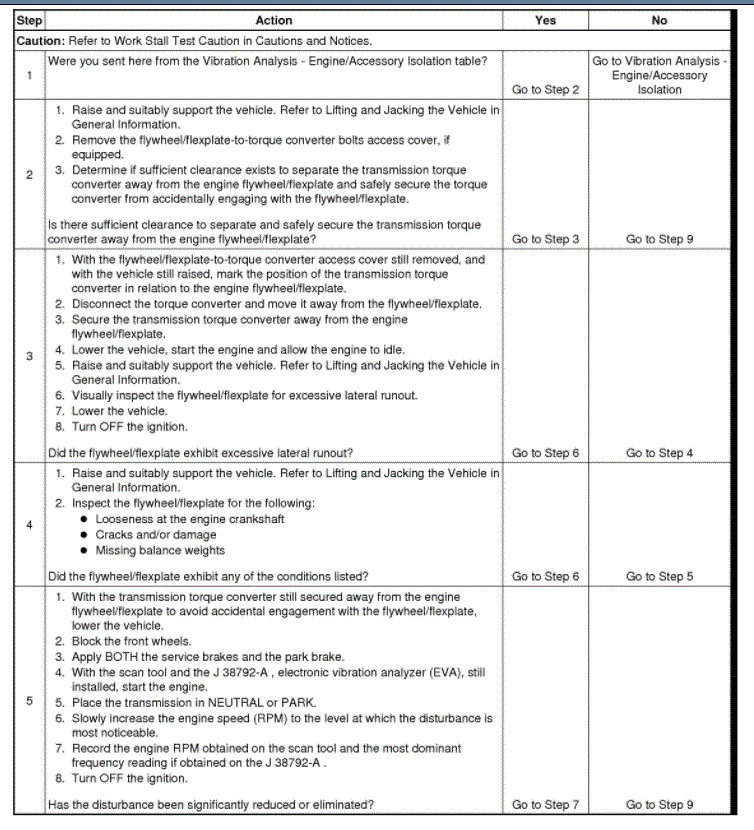

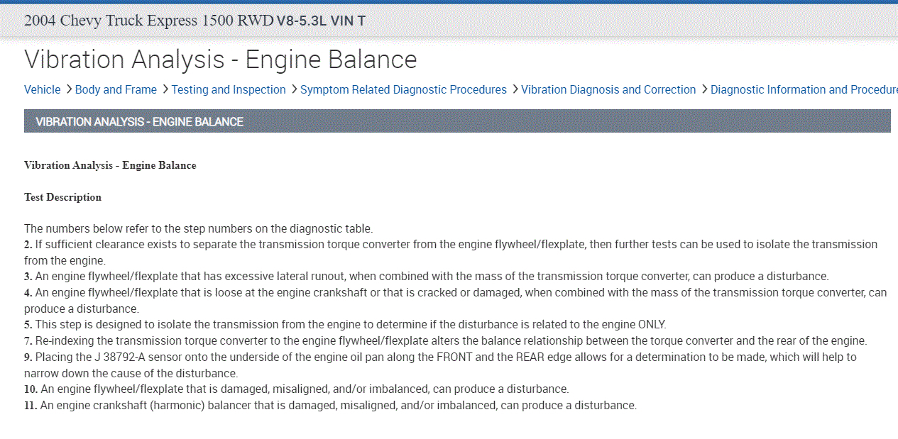

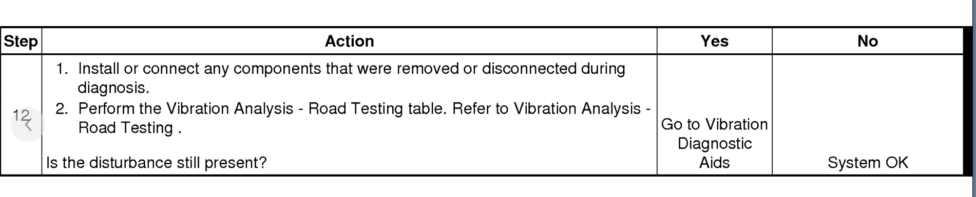

If you look at the attached pic (number 1) it shows how to test for flywheel runout using a dial indicator. The remaining pics, related to vibrations, are for testing for flexplace lateral runout and for issues with the torque converter itself.
Check these things and let me know if you have other questions.
