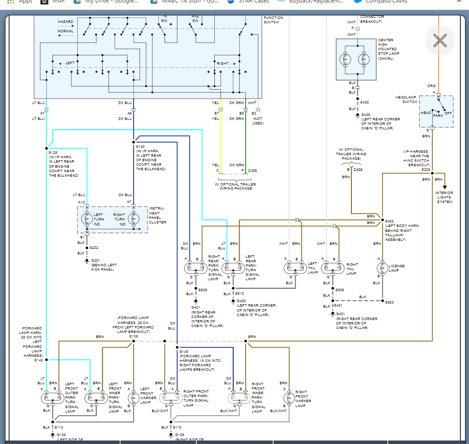

The parking lights/license plate/tail lamps and other lights do not work. I have changed the fuse with a known good fuse and they still do not work. Help!
Nov 3, 2009 at 7:29 PM

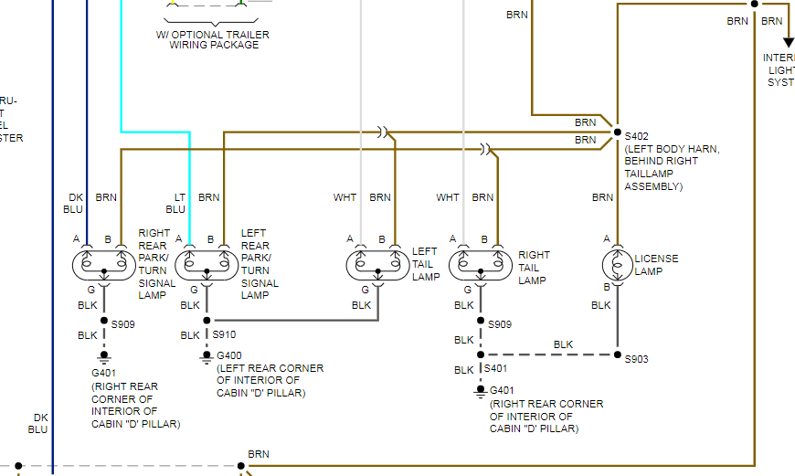

More then likely you have a wiring issue. These lights share a feed wire and ground. So we need to use the wiring diagram and the guides below to test the wiring to see where you have power. Once we find out where we have power and we can go from there.
Here are the guides on how to test the wiring:
https://youtu.be/Hlna_kUt7As
Let us know what you find. Thanks
