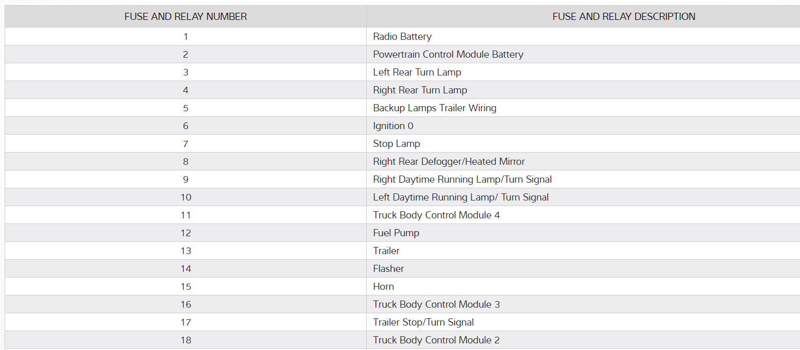

Misfire Detected-No EBTCM/PCM Serial Data WHAT IS THIS ?
Jul 22, 2010 at 11:40 PM
BLUELIGHTNIN6
  • 16,542 POSTS

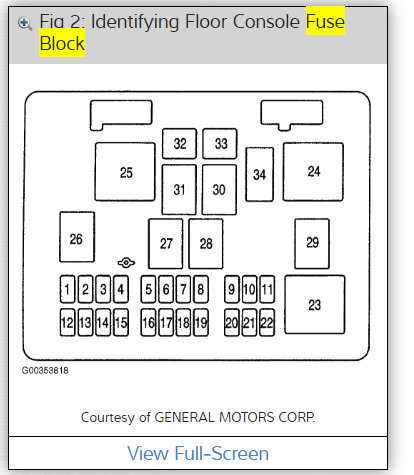

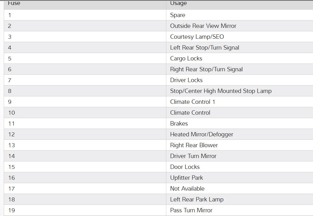

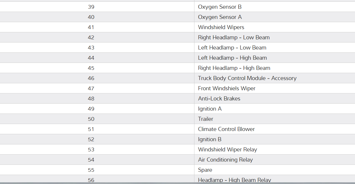

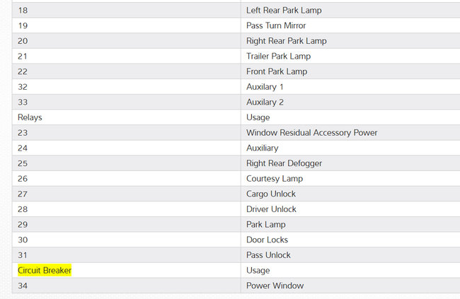

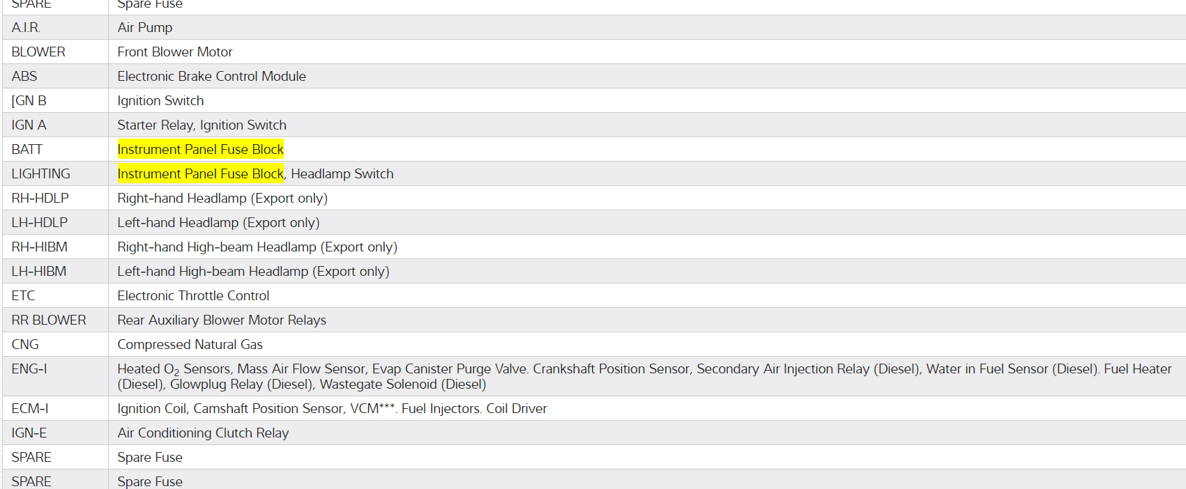

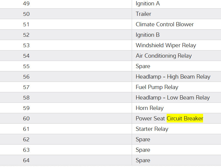

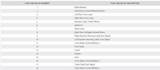

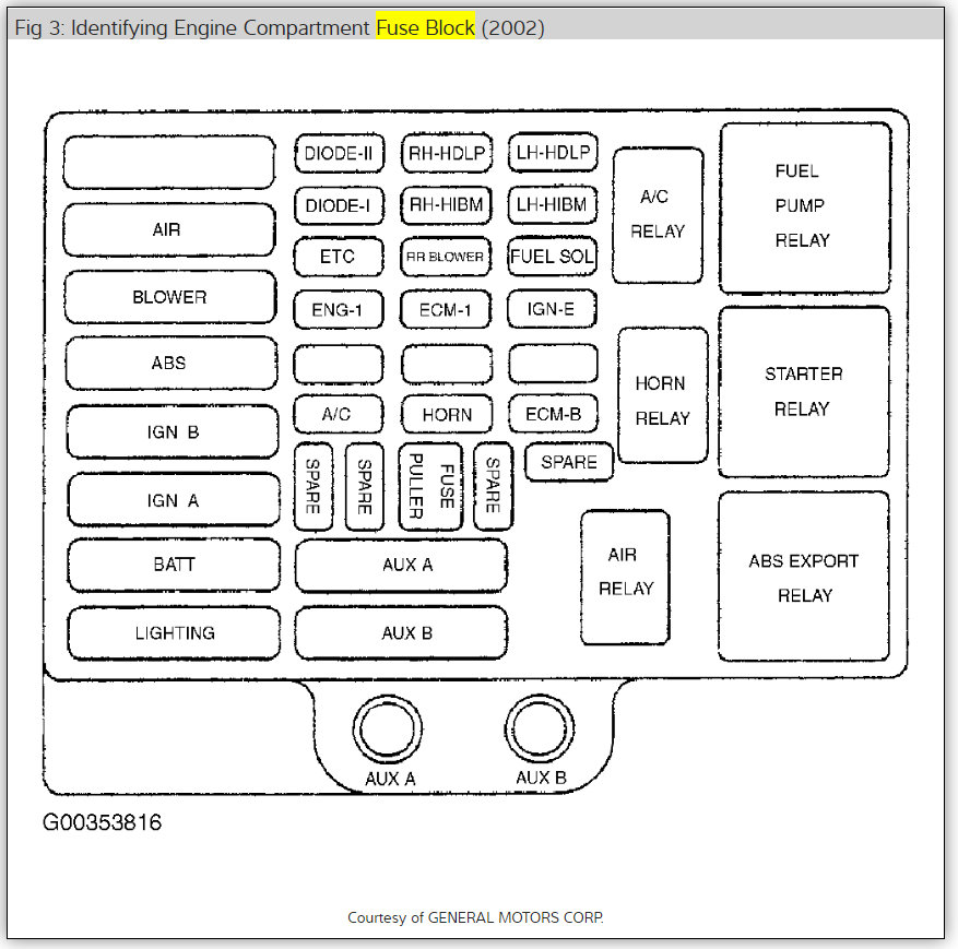

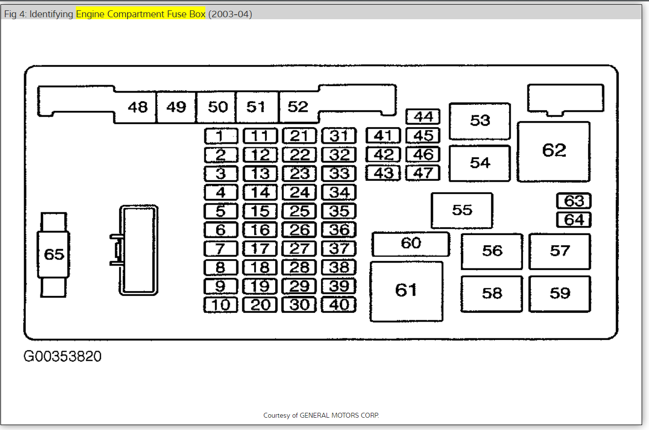

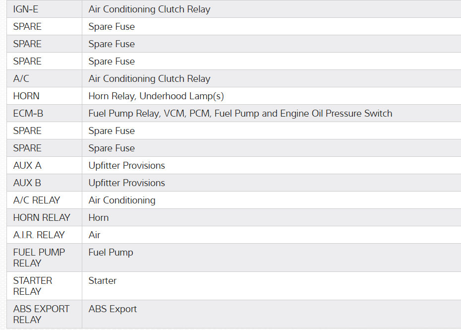

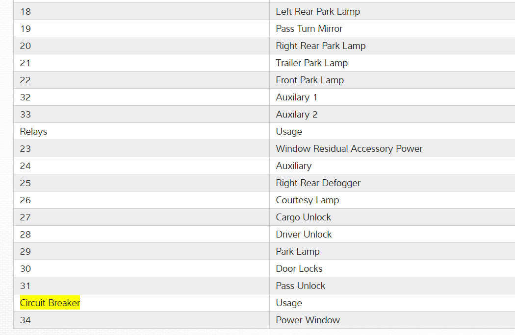

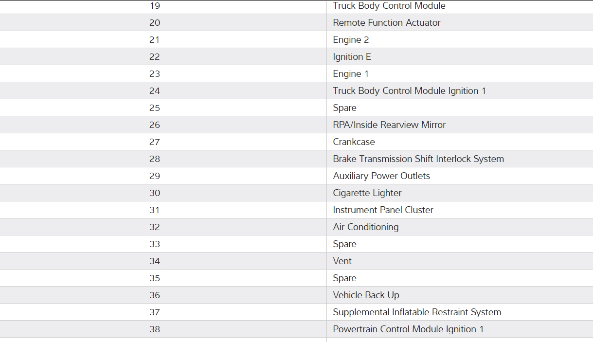

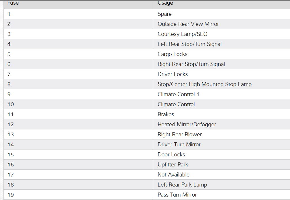

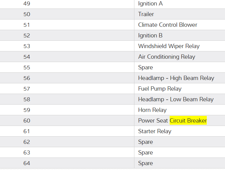

It sounds like the PCM fuse is popped but to be sure here is a guide to help you test the fuses with the fuse locations below. I would check all the fuses BTW
Check out the diagrams (Below). Please let us know what you find. We are interested to see what it is.
