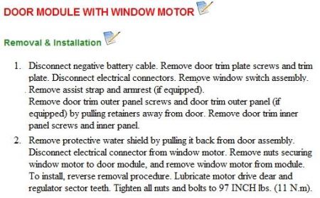

how do i change power window motor on this van

https://images.2carpros.com/forum/automotive_pictures/261618_Noname_2304.jpg
