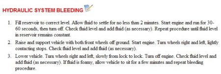

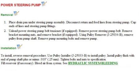

https://images.2carpros.com/forum/automotive_pictures/261618_Noname_1655.jpg
https://images.2carpros.com/forum/automotive_pictures/261618_Noname2_515.jpg
