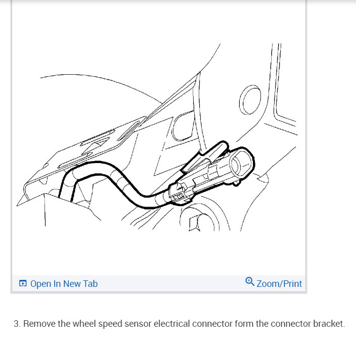

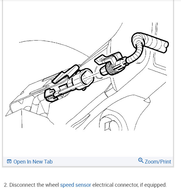

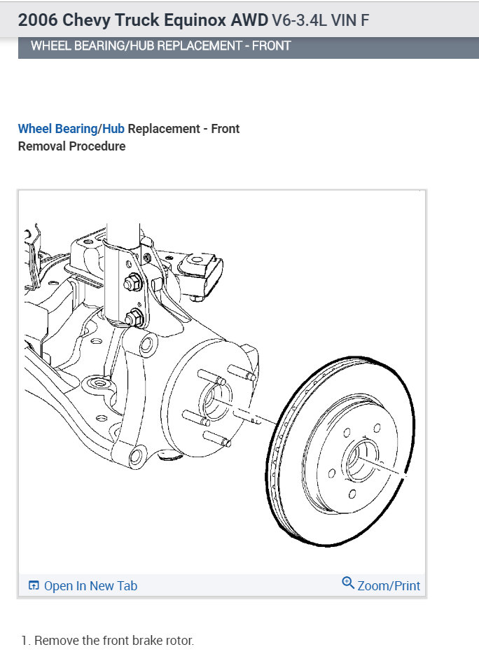

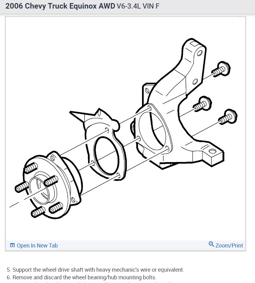

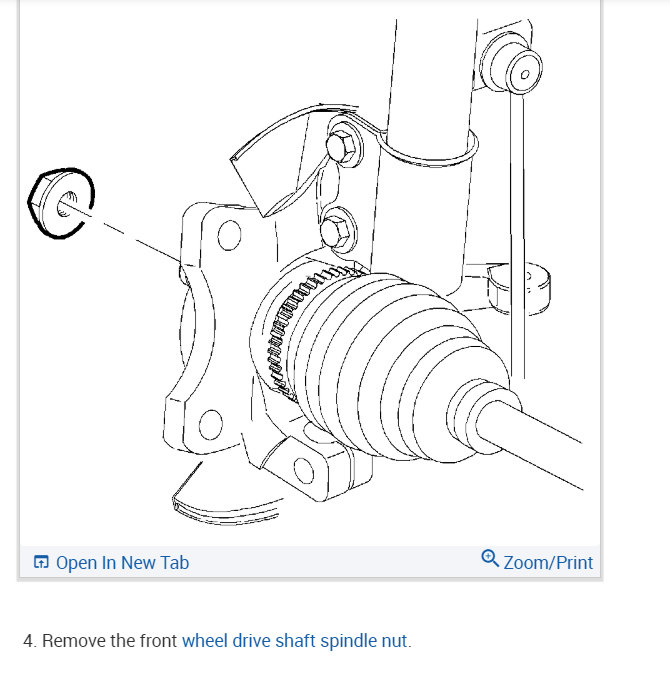

Started making a loud humming noise on the road. I have no alerts on the OnStar diagnosis, the noise is not there when I am at idle or low speed. This just started all of a sudden
Feb 7, 2009 at 10:45 PM
DOCHAGERTY
  • 9,606 POSTS
This sounds like you have a front bearing hub that is out which is common for a humming noise. Here is a guide to help walk you through the steps with instructions in the diagrams below how to fix your car.
https://www.2carpros.com/articles/bearing-hub-replacement
Check out the diagrams (Below). Please let us know what you find.
Feb 8, 2009 at 2:04 AM
JLB1943
This was great I got new bearing hub for $143.00 fix it back on the road! I love this site
