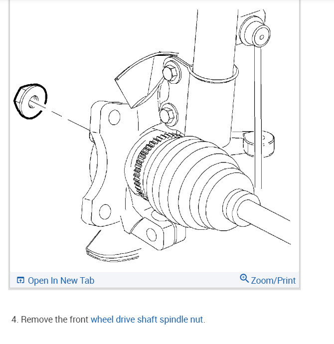

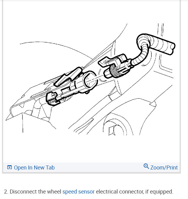

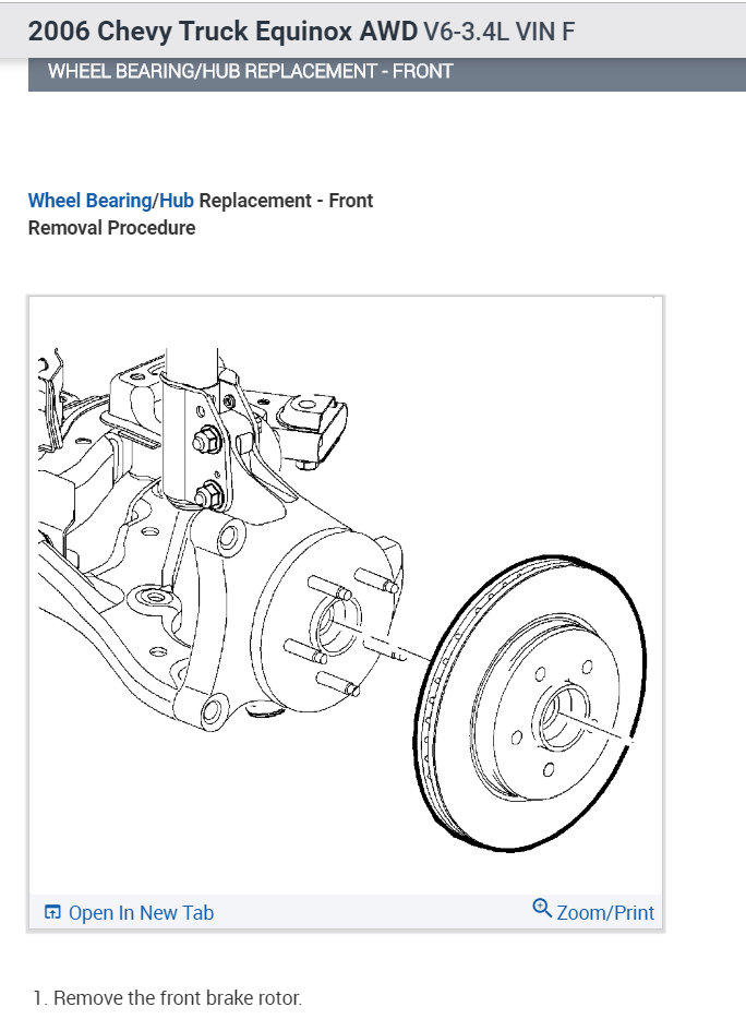

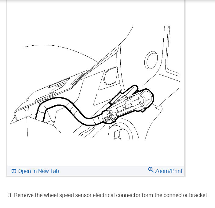

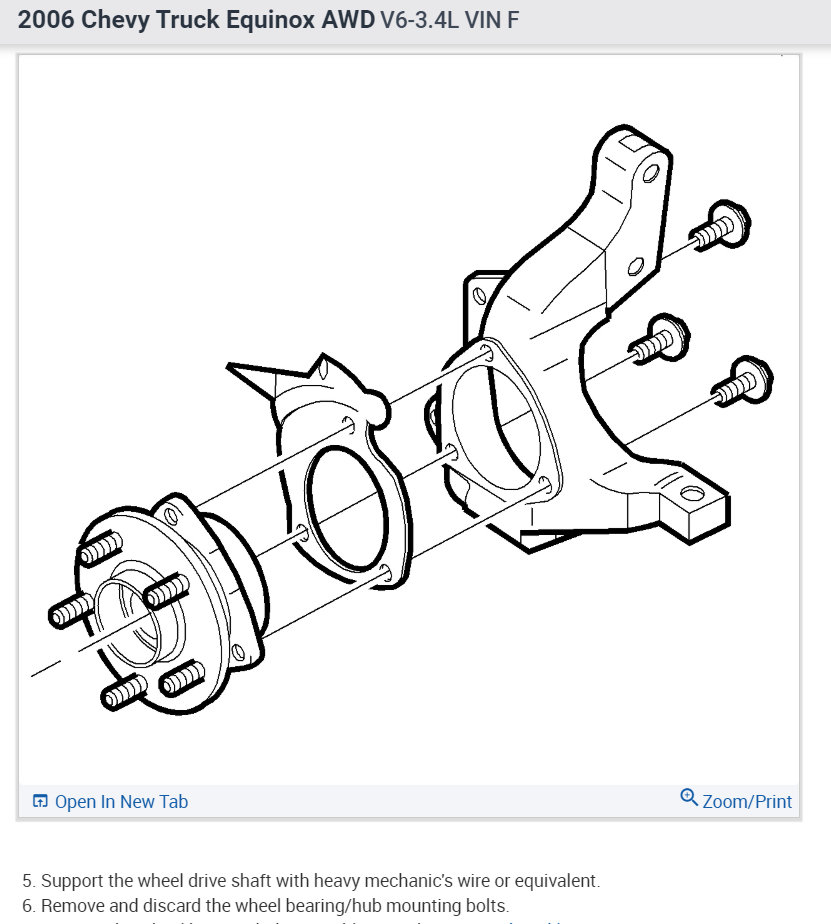

This sounds like one of the front bearing hubs is out causing the ABS wheel speed sensor not to work correctly. To find out which one lets run the codes by following this video.
https://youtu.be/rTtAnsOlZU4
Instructions on how to replace the hubs is in the diagrams below.
