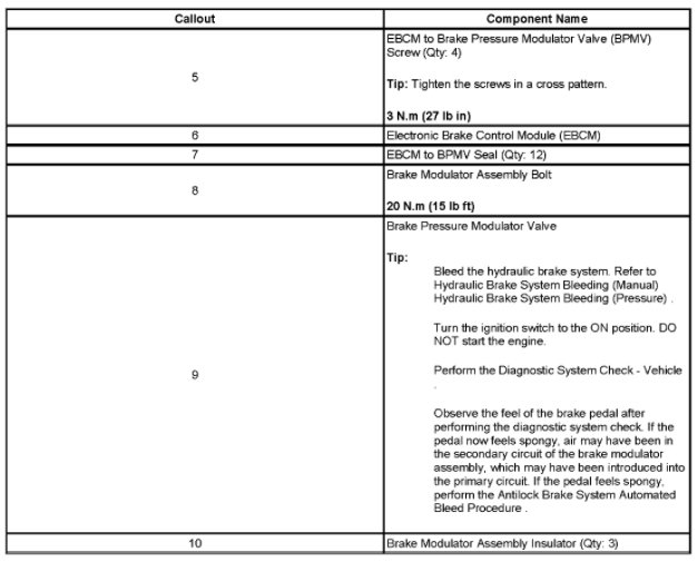

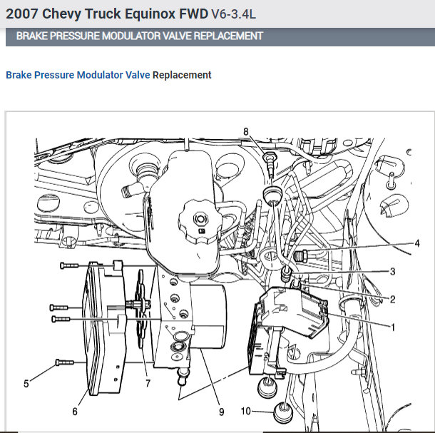

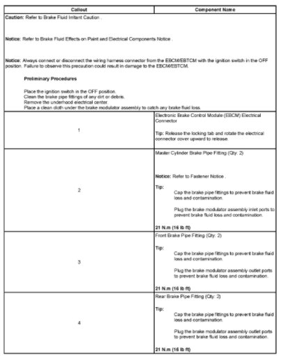

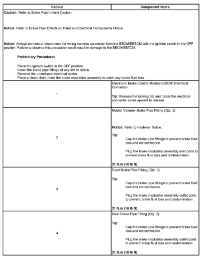

I have a code that says I need a new ABS module.

Here is the information you requested. I've attached picture steps below on how to change the ABS hydraulic unit- modulator valve on your truck below. Hope this helps and thanks for using 2CarPros.
