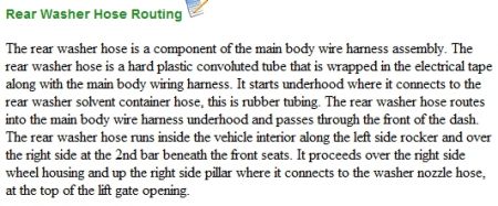

I have never been able to get rear window washer fluid to come out. There is a small tube attached to the fluid reservoir that will shoot the fluid straight up and out when the rear washer fluid knob is turned. Can't figure out where the tube is supposed to connect to send the fluid to the back window. Any ideas?
