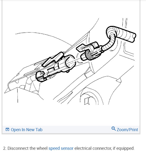

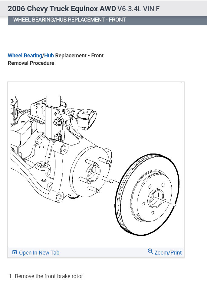

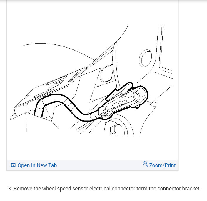

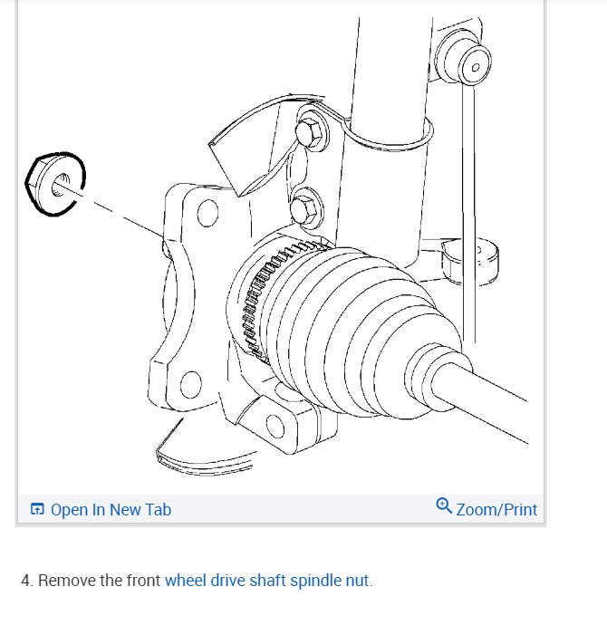

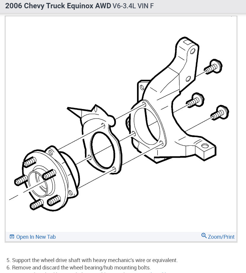

I have seen the front bearing hubs cause this issue here is a guide to help you step by step with instructions in the diagrams below to show you how on your car.
https://www.2carpros.com/articles/bearing-hub-replacement
Apr 19, 2009 at 1:48 AM
DRUMMER1
  • 7 POSTS
I just love you guys you hit it right most of the time I had this problem got a new bearing hub and BAM all fixed! cost me $134.00
