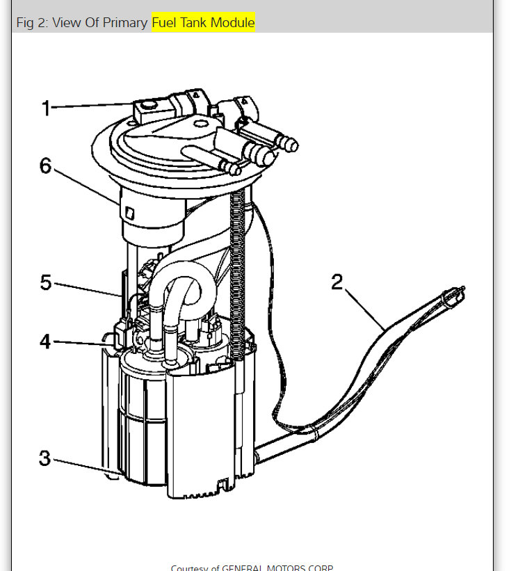

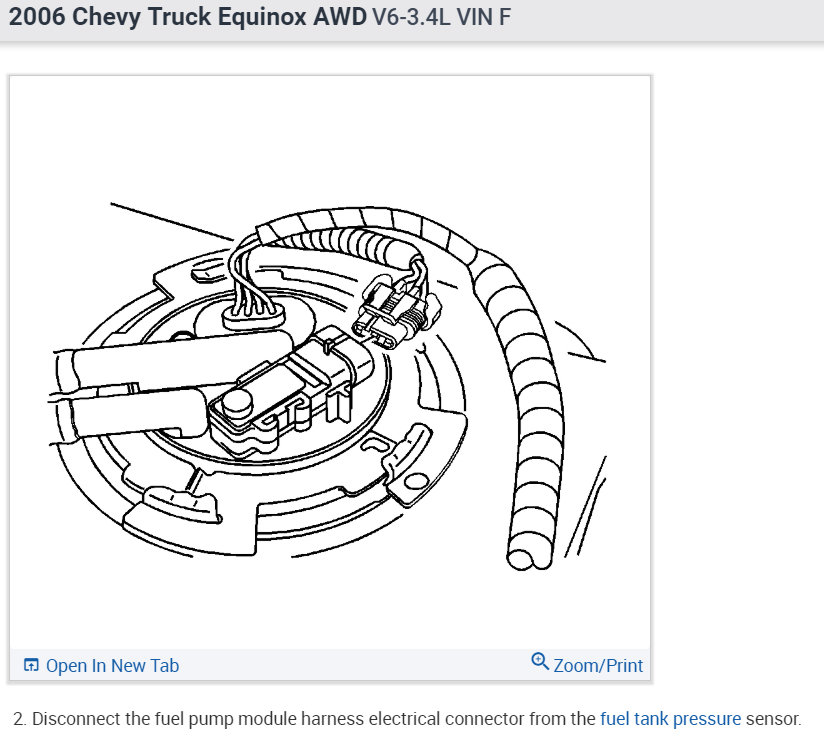

where is the fuel filter located for my car... it did not pass inspections they told me to check my vac and change my fuel filter.... just not sure where it is located at?
Jan 11, 2010 at 8:04 PM
BLUELIGHTNIN6
  • 16,542 POSTS

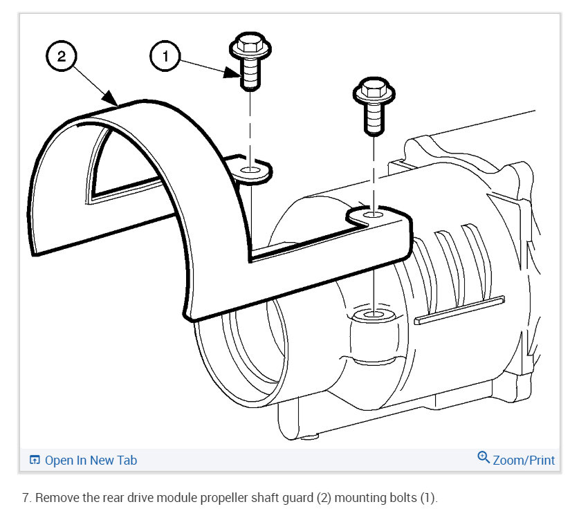

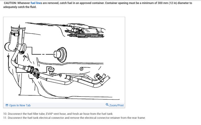

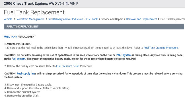

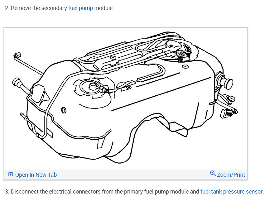

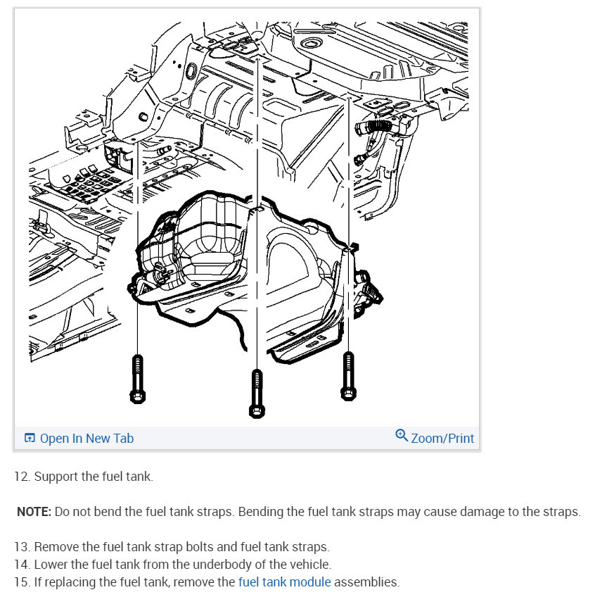

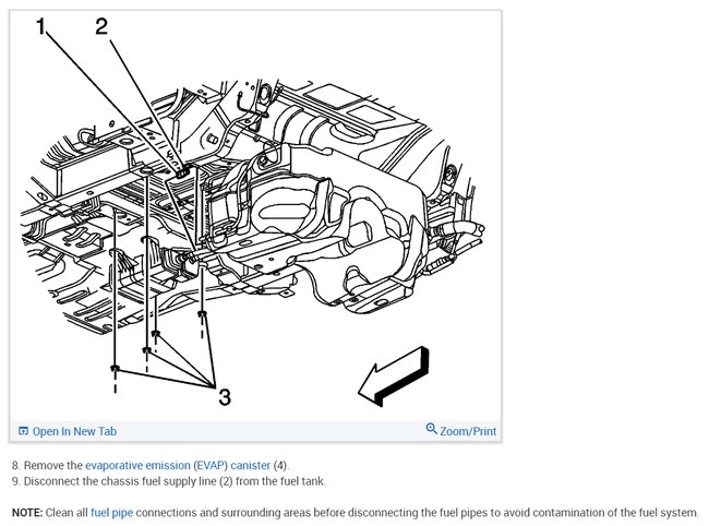

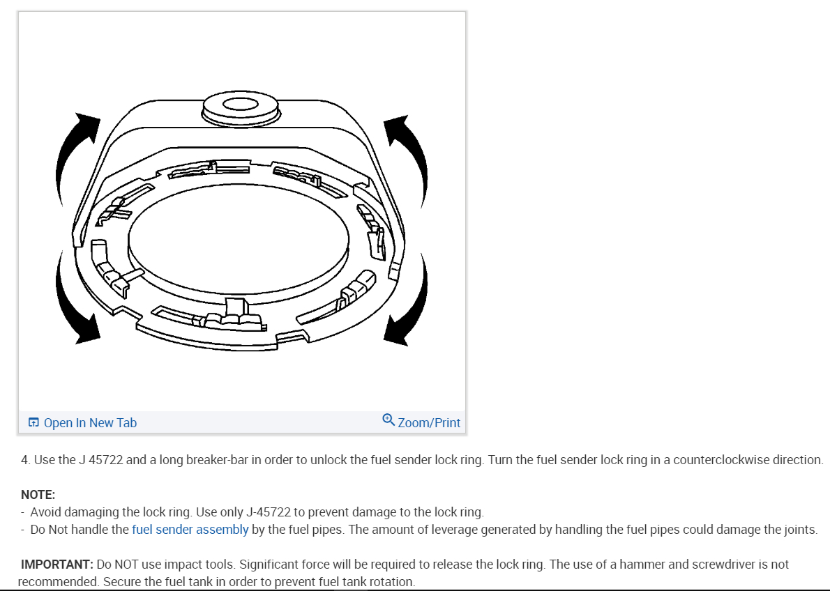

The fuel filter is a non-serviceable type, located inside the gas tank with the fuel pump module. It is not necessary to change the fuel filter unless you are having issues with fuel supply to the engine. Here are diagrams on how to change it. Check out the diagrams (Below). Please let us know if you need anything else to get the problem fixed.

The fuel filter is in the tank as part of the fuel pump module.
