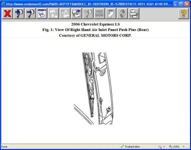

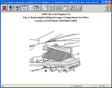

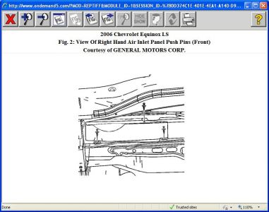

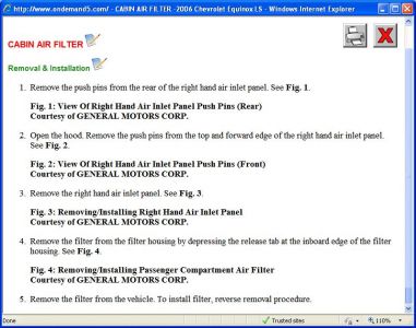

Where is the cabin filter located?
Thursday, May 13th, 2010 AT 7:50 PM
SATURNTECH9
  • 30,869 POSTS
https://www.2carpros.com/forum/automotive_pictures/416332_2006_chevy_equinox_cabin_air_filter_replacement_1.jpg
https://www.2carpros.com/forum/automotive_pictures/416332_2006_chevy_equinox_cabin_air_filter_fig1_1.jpg
https://www.2carpros.com/forum/automotive_pictures/416332_2006_chevy_equinox_cabin_air_filter_fig2_1.jpg
https://www.2carpros.com/forum/automotive_pictures/416332_2006_chevy_equinox_cabin_air_filter_fig3_1.jpg
https://www.2carpros.com/forum/automotive_pictures/416332_2006_chevy_equinox_cabin_air_filter_fig4_1.jpg
There's the information you requested.
