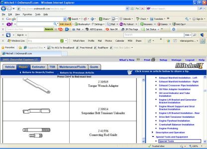

trying to remove the belt from the engine. I do not have a ratchet that will fit between the rail and the tensioner arm. Is this a tool made bt Chevy.

https://images.2carpros.com/forum/automotive_pictures/416332_belt_tool_2.jpg
theres a pic of it tool number j39914 but u should be able to use a breaker bar or put a floor jack under the oil pan with some wood between the jack and oil pan and take the upper mount and jack the engine up to gain more access to the tensior.let me know how it goes.
