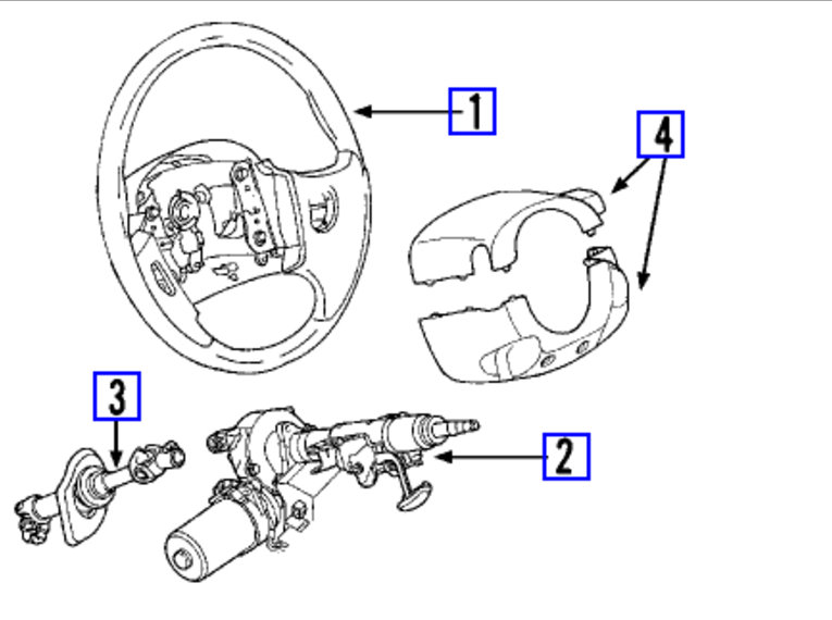

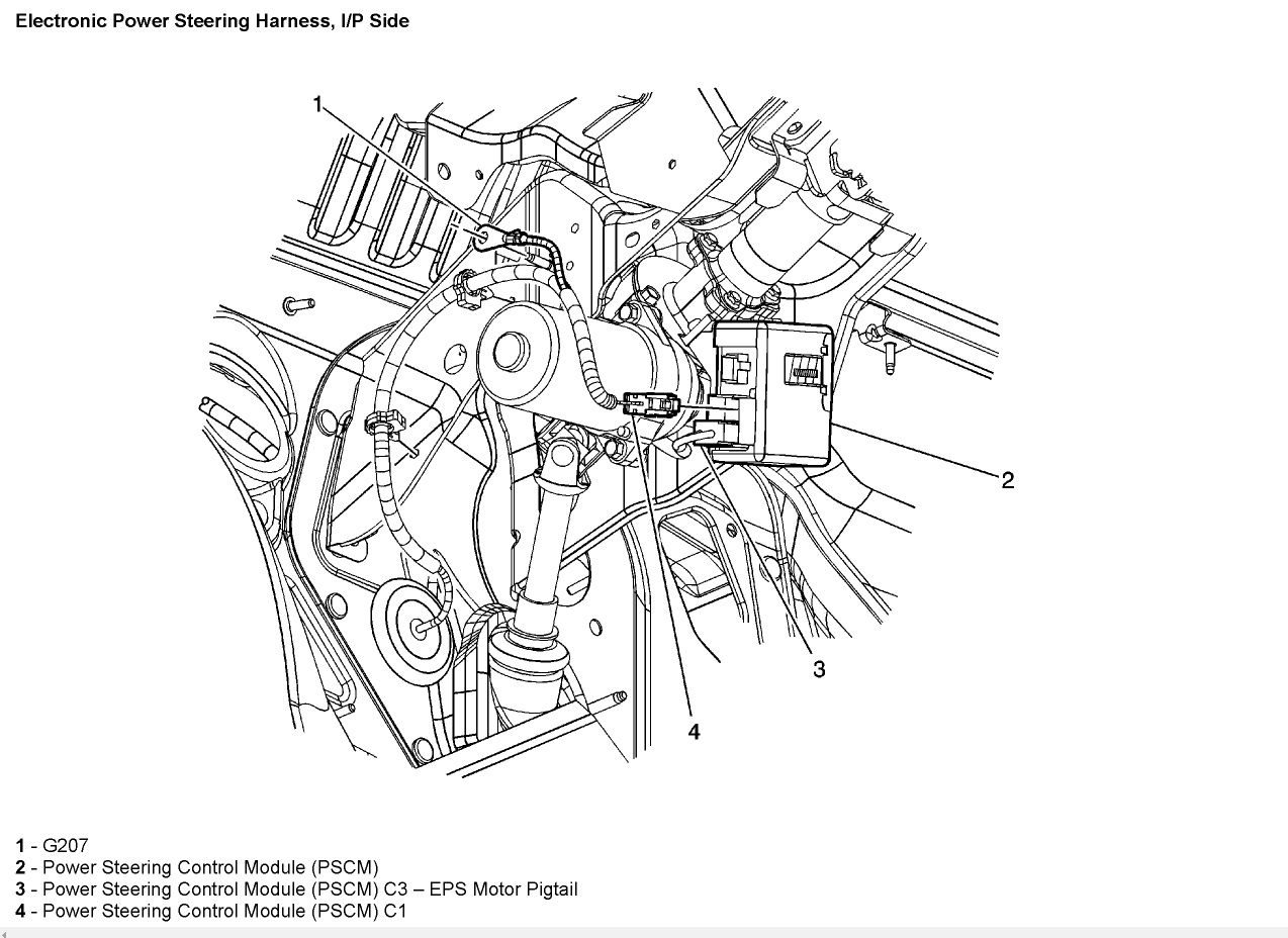

2005 chevy equinox: started last nite: put into drive, felt like the power steering 'locked up' and was extremely difficult to control the steering to drive home
Aug 16, 2009 at 7:14 AM
  • 55,658 POSTS

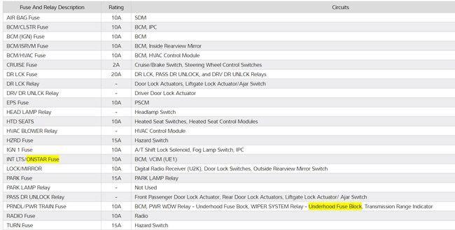

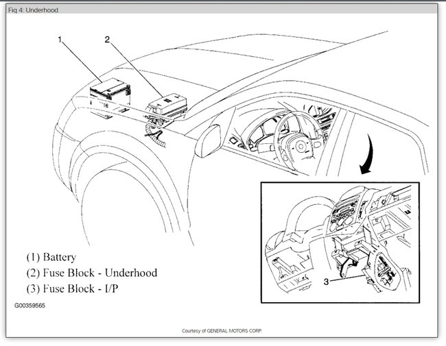

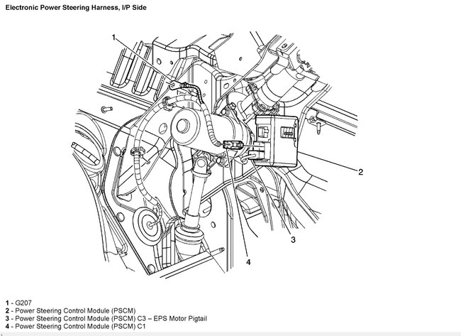

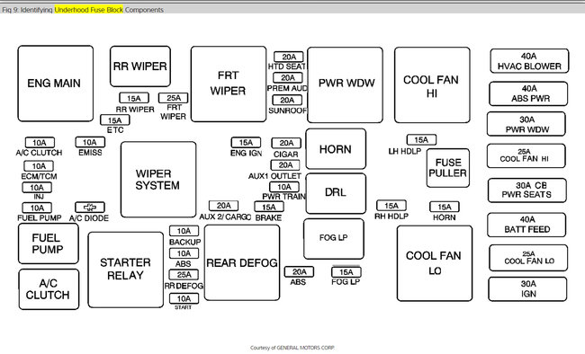

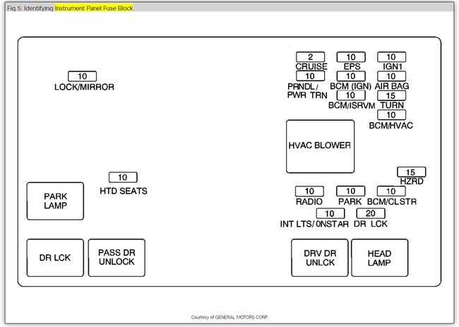

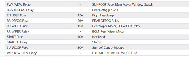

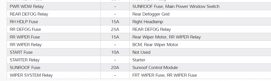

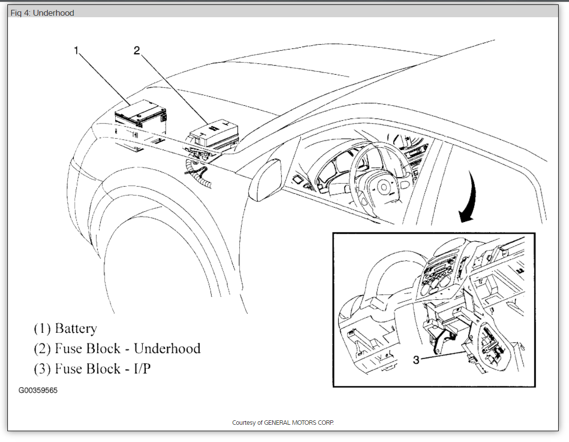

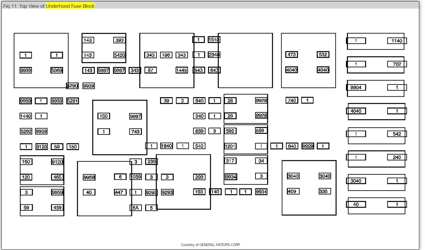

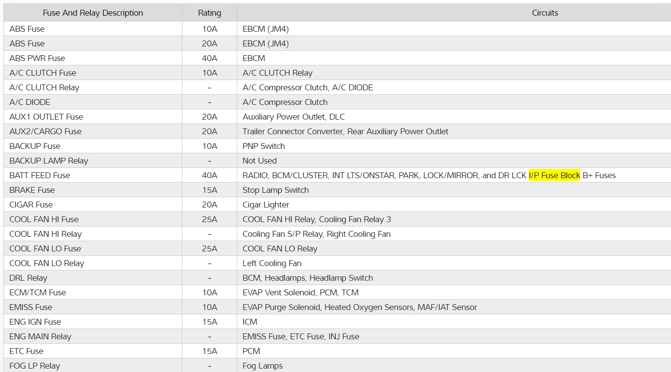

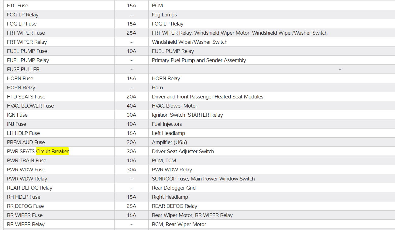

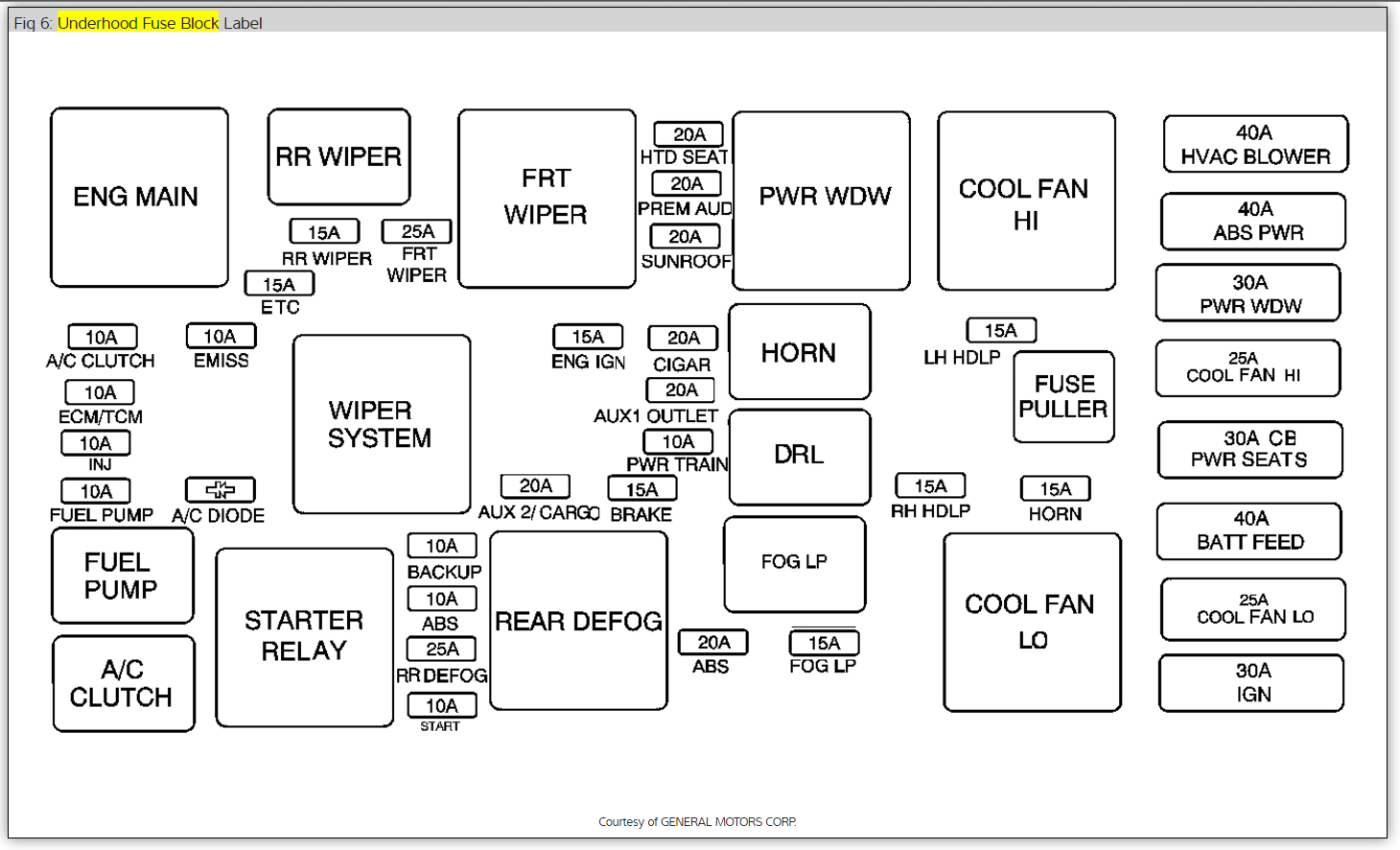

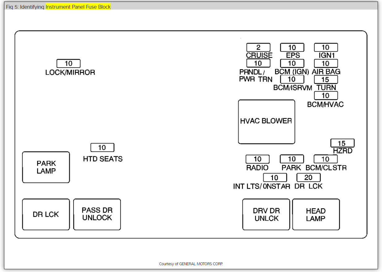

This car has EPS which is electrically powered the unit sits just under the steering column. I would start by checking the fuses and relays to make sure they are all working before condemning the EPS itself.
Here is a guide and some diagrams to help you check for the problem and then if the unit is bad how to change it.
and
Please let us know what happens so we can keep helping you.
