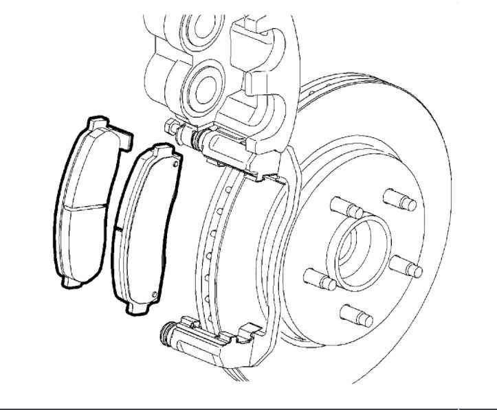

Was looking for some help doing the brakes on my van, any help is greatly appreciated.
Jun 7, 2008 at 3:49 AM
Good afternoon,

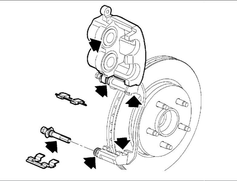

I attached the procedure below for the repair as well as a guide for the repair. Check out the diagrams (Below).

4. Raise and support the vehicle. Refer to Vehicle Lifting.
5. Remove the tire and wheel assembly.
6. Install and firmly hand tighten 2 wheel nuts to opposite wheel studs in order to retain the rotor to the hub.

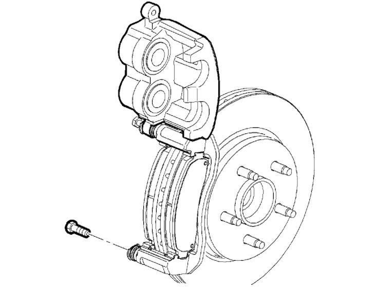

7. Install a large C-clamp over the body of the brake caliper with the C-clamp ends against the rear of the caliper body and against the outboard brake pad.
8. Tighten the C-clamp evenly until the caliper piston is compressed into the caliper bore enough to allow the caliper to slide past the brake rotor.
9. Remove the C-clamp from the caliper.
10. Remove the brake caliper lower guide pin bolt.
11. Notice: Support the brake caliper with heavy mechanic's wire, or equivalent, whenever it is separated from its mount and the hydraulic flexible brake hose is still connected. Failure to support the caliper in this manner will cause the flexible brake hose to bear the weight of the caliper, which may cause damage to the brake hose and in turn may cause a brake fluid leak.
Without disconnecting the hydraulic brake flexible hose, pivot the caliper upward and secure the caliper with heavy mechanics wire, or equivalent.
12. Remove the brake pads from the caliper mounting bracket.
13. Remove the brake pad retainers from the caliper bracket.
14. Thoroughly clean the brake pad hardware mating surfaces of the caliper bracket, of any debris and corrosion.
15. Inspect the brake caliper guide pins for freedom of movement, and inspect the condition of the guide pin boots. Move the guide pins inboard and outboard within the bracket bores, without disengaging the slides from the boots, and observe for the following:
^ Restricted caliper guide pin movement
^ Looseness in the brake caliper mounting bracket
^ Seized or binding caliper guide pins
^ Split or torn boots
16. If any of the conditions listed are found, the brake caliper guide pins and/or boots require replacement.
