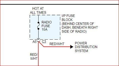

Was it the Radio fuse that you pulled out?

Hi
This post was from about 11 years ago so I don't expect they will respond. However, the issue that they are describing is when the radio is telling them there is an error and it can't eject because the radio is locked. Pulling the fuse will reset the radio and allow it to eject the disc as long as it is not a hard fault that resets immediately.
If your CD is just stuck because it was jammed in there or the CD slot is dirty then this will not work. The only way I know to get it out then is to remove the radio and take the cover off and push it out.
As for reprogramming the radio, it should not need this. Just pulling the fuse is removing the memory from it so you will need to reset the presets.
Let me know if there is any other info I can help with.
