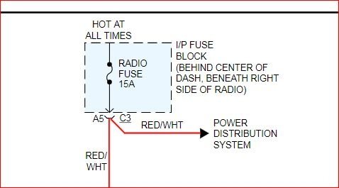

Please note I have a good cd stuck in a ac Delco player, will not eject, and give error message when you try to do so as no cd and then check cd, this is a 1 and1 cd unit player, cd will will but will not eject. I have ask other Chevy outlets, the chevy customer service who are atrocious and vin I asked the mfg ac Delco, none of these chevy-gm entities have not gotten back to me with a response, can you help?

Try pulling the fuse out to let the system reset itself. Mine had the same problem, after I pulled the fuse it reset and I was able to eject the cd's and it has been working fine.

Pulling the fuse worked for me. While it was out I vacuumed out the cd slot, blew in compressed air, vacuumed again and when I put in a fuse IT ALL WORKS AGAIN.
The down side is that while I was trying to replace the fuse in its RH console cubby hole I dropped it (into a black hole?) And had to go buy fuses.

GMIMI2019
Was it the Radio fuse that you pulled out?
Did you have to reprogram the Radio?

Hi
This post was from about 11 years ago so I don't expect they will respond. However, the issue that they are describing is when the radio is telling them there is an error and it can't eject because the radio is locked. Pulling the fuse will reset the radio and allow it to eject the disc as long as it is not a hard fault that resets immediately.
If your CD is just stuck because it was jammed in there or the CD slot is dirty then this will not work. The only way I know to get it out then is to remove the radio and take the cover off and push it out.
As for reprogramming the radio, it should not need this. Just pulling the fuse is removing the memory from it so you will need to reset the presets.
