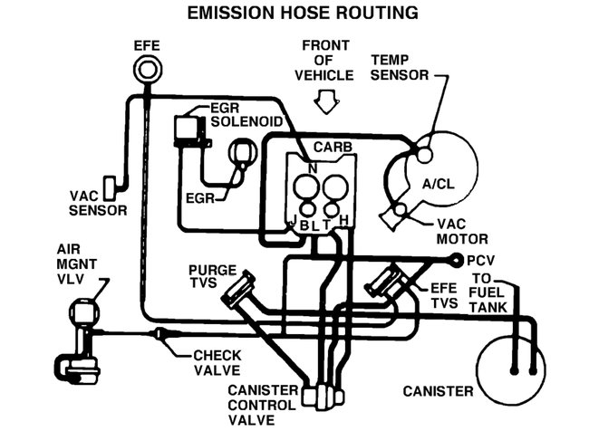

I recently replaced the stock 305 engine with a 350. Im not sure Ive got the vacuum lines where there supposed to go. Haynes manual is no help, they say refer to the veci sticker on the fan shroud. Do you have a vacuum line diagram you can send me.

I recently bought a 1981 El Camino and I live in California they took off the smog pump and pulled all the vacuum lines I can't figure out where the line go can you help?
Jul 30, 2019 at 9:02 AM (Merged)
BLUELIGHTNIN6
  • 16,542 POSTS
https://images.2carpros.com/forum/automotive_pictures/261618_Noname_2605.jpg

I some how got my color codes mixed up from my ac selector controls. now vacume doors don't open & close like they should. is there somewere I could find a diagram?

I looked, but out program dosent go back that far, but, usually the servos have a colored dot on them to coincide with the colored stripe on the vacuum line.
