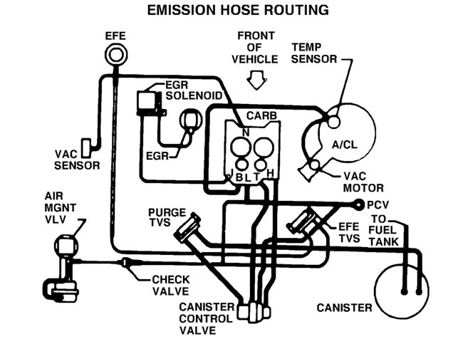

Vacuum line diagram
J.MASON
  • 1985 CHEVROLET EL CAMINO
  • V8
  • 2WD
  • 50,000 MILES
I recently replaced the stock 305 engine with a 350. Im not sure Ive got the vacuum lines where there supposed to go. Haynes manual is no help, they say refer to the veci sticker on the fan shroud. Do you have a vacuum line diagram you can send me.
Wednesday, April 22nd, 2009 AT 12:25 PM

Wednesday, April 22nd, 2009 AT 12:55 PM
ARLEF
  • 1981 CHEVROLET EL CAMINO
  • 6 CYL
  • 2WD
  • 81,000 MILES
I recently bought a 1981 El Camino and I live in California they took off the smog pump and pulled all the vacuum lines I can't figure out where the line go can you help?
Tuesday, July 30th, 2019 AT 4:02 PM (Merged)
BLUELIGHTNIN6
  • 16,542 POSTS
https://www.2carpros.com/forum/automotive_pictures/261618_Noname_2605.jpg

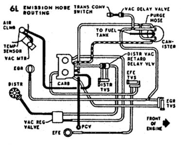

ELCAMI
  • 10 POSTS
  • 1977 CHEVROLET EL CAMINO
Engine Mechanical problem
1977 Chevy El Camino 6 cyl Two Wheel Drive Automatic
hi,
I'm the first owner of 77 4.1 6 cil. Elcamino.
Over the years many mechanical disconnected all my vacuum hoses from carburetor etc.
Q1: is that a way you will publish a vacuum hose diagram? (I have rochester monojet carburetor)
Q2: my ideal stop solenoid is disconnected, where to connect the electric wire?
Q3: if car & weather are cold, what is the position of chock shelf should be? Fully close?
+1
HMAC300
  • 48,601 POSTS
As far as your diagramn goes, try a library and see if htey have a manual on it. It would tell you where stuff goes. The solenoid wire should connect to a tab sticking up at the rear of the solenoid, if it's not busted off. The choke shelf should be closed when it's cold but as soon as it starts there should be a shoke pulloff to open the plate a little bit. So it will idle fast an send black smoke out the exaust and idle like crap. There should be a small hose that goes to a vacuum motor to a full vacuum port on the carb.
+1
