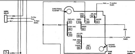

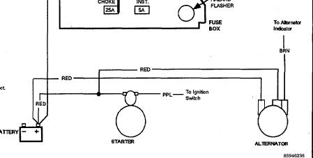

Jump the old, dead battery and it started; didn't hold a charge after running for 30-40 minutes.
Jumped it again and accicently left the ignition switch on. Smoke came from area near alternator bracket where jumper cable was connected. After that it would not turn over and no lights or horn.
Replaced battery. Now have lights and horn but no radio. No apparent burned wiring and no lingering odor.
Checked some of the fuses and none appeared to be bad.
I have limited experience but can replace an alternator and maybe a starter. Just want to narrow the problem down to deternine if it is something I can do or not.
Thanks for your help. KT

Welcome to the forum. Thanks for the donation. Are you saying the starter won't crank? If you saw smoke, something burned? I saw a wiring diagram for starter circuit. below. You need to use a testlite on the fuse circuit, even if the fuse is good, if no voltage, the circuit is dead. Make sure battery has a full charge and connections are good.

The starter won't crank.
I'm not sure if I have the right test light and it's been years since I used one.
If the alternator was shorted out would the starter not crank. I could have the alternatore tested.

What's got me is the clock, headlights and horn work but not the radio, turn signals, or AC/Heater fan.

I found this on the turn fuse, use a testlite. The circuit should go hot when you turn on the key.
