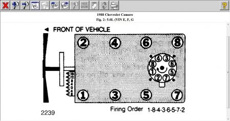

I have a '71 350 with HEI and I need the diagram for plug wires on the cap. I have a misfire and i just put new wires on it today but i think the diagram in my book wrong. If it is not wrong then I have a faulty plug cause I had a bad wire on number 7 yesturday

See below
https://images.2carpros.com/forum/automotive_pictures/12900_hevy_fchevy_fo_1.jpg
