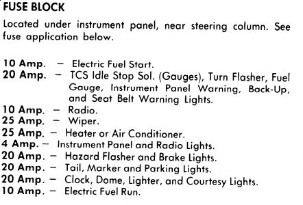

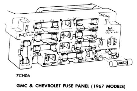

where is turn signal located
Nov 15, 2009 at 7:01 AM
MERLIN2021
  • 17,250 POSTS
Most of the older cars had them right on the fuse panel, I only go back to 73' but it should look like this. [img] Fuse ID may be this, but it is again from 73'.

67 models found! Flasher in top right corner, Flasher NOT shown!
https://images.2carpros.com/forum/automotive_pictures/62217_67_Fuse_panel_1.jpg
Directional signal flasher in top left corner(not shown).
