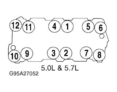

This is a '95 chevy truck, V8,350 engine. What lbs. torque do you use on the intake bolts?

Hello, Torq is 35 foot pounds...
https://images.2carpros.com/forum/automotive_pictures/188069_95_350intaktorq_1.jpg
