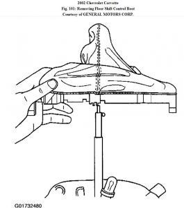

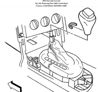

How do you replace the PRNDL bulb and what is the bulb number?

TRANS FLOOR SHIFT CONTROL INDICATOR LAMP REPLACEMENT Removal Procedure 1. Remove the floor shift control. Refer to FLOOR SHIFT CONTROL ASSEMBLY . Fig. 100: Removing Floor Shift Control Knob Courtesy of GENERAL MOTORS CORP. 2. Remove the floor shift control boot assembly. Refer to FLOOR SHIFT CONTROL BOOT . 3. Remove the lamp socket. 4. Remove the bulb from the lamp socket. Fig. 101: Removing Floor Shift Control Boot Courtesy of GENERAL MOTORS CORP. Installation Procedure 1. Install the bulb to the socket. 2. Install the socket to the shift boot assembly. 3. Install the shift boot to the floor shift control. Refer to FLOOR SHIFT CONTROL BOOT . Fig. 102: Installing Floor Shift Control Boot Courtesy of GENERAL MOTORS CORP. 4. Install the floor shift control to the console. Refer to FLOOR SHIFT CONTROL ASSEMBLY .
