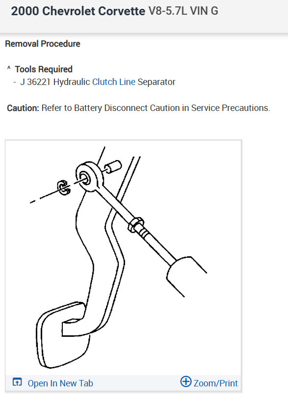

I noticed after my car sat for a week that the clutch has a lot of play in it. I can depress the clutch halfway to the floorboard before I feel any resistance. From the time I feel resistance to when the clutch hits the floorbard is now very minimal. There's no odor, noise, or the like--only the free play. Thoughts?

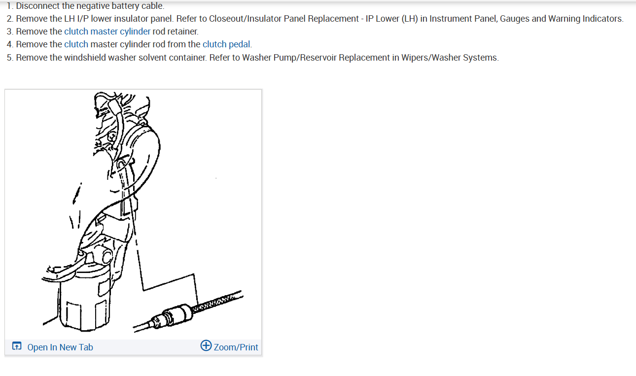

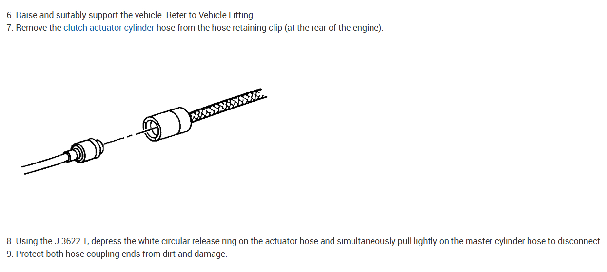

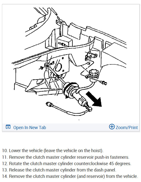

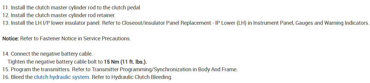

Yes, if the clutch disc has come apart it will cause the pressure plate to move inward causing the free play, The system is self bleeding so don't worry about that, but it could be a internal leak inside the clutch master. Please watch this video to help us understand what's going on and I have included how to change the clutch master out as well.
https://www.youtube.com/watch?v=EpBMj5ZY_bo&t
And this guide can help as well
https://www.2carpros.com/articles/clutch-doesnt-work-sometimes-or-not-at-all
Check out the images (below). Please upload pictures or videos in your response of any problems so we can see what to help you with.
