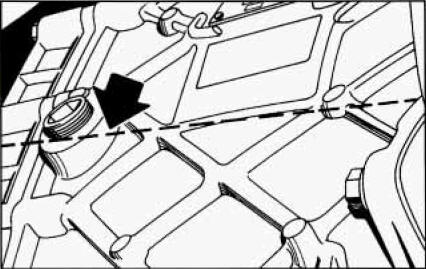

How can I check the transmission oil?

Hello sheldon corey Check the fluid level only when your engine is off, the vehicle is parked on a level place and the transmission is cool enough for you to rest your fingers on the transmission case.
https://images.2carpros.com/forum/automotive_pictures/46384_Servic34_1.jpg
Then, follow these steps: 1. Remove the filler plug. 2. Check that the lubricant level is up to the bottom of the filler plug hole. 3. If the fluid level is good, install the plug and be sure it is fully seated. If the fluid level is low, Add fluid at the filler plug hole. Add only enough fluid to bring the fluid level up to the bottom of the filler plug hole. 3. Install the filler plug. Be sure the plug is fully seated. 4. Tighten the plug to 20 1b.-ft. (27 N-m).
