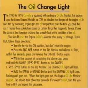

Procedure to reset "change oil" light after service in
1992 corvette.(not in owners manual) thanks...J.

Hello, I came across this, I'm not sure if it is readable?
https://images.2carpros.com/forum/automotive_pictures/170934_oil_life_1.jpg
