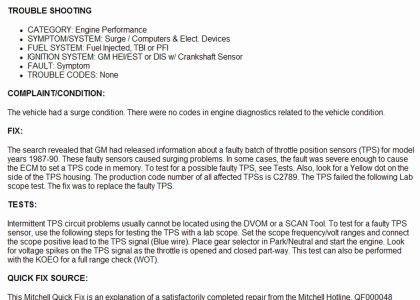

got a 90 corvette vin 8 stall after a half hour of running. put new dist and module in.Tried an ecm..still doing the same thing. NO injector pulse when it stalls. Spark is fine. Any ideas? I am at my wits end.....

Have you checked the fuel pressure when the pulse is gone? Try that and let me know what it is...

37-40 psi

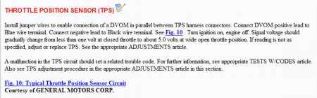

Try testing the TPS for WOT.
https://images.2carpros.com/forum/automotive_pictures/62217_TPS_Fualty_1.jpg
https://images.2carpros.com/forum/automotive_pictures/62217_TPSTest_1.jpg
