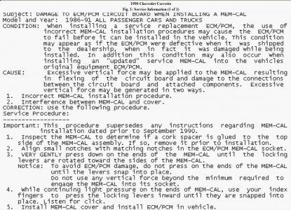

This is from a Chevy Tech bulliten to thier dealers, may be your concern?:
EXPERTEC TSB TECHNICAL SERVICE BULLETIN Reference Number(s): 476503, Â Date of Issue: Â 01/24/94 Related Ref Number(s): 476503 ARTICLE BEGINNING HARD START ON HOT RESTART/ - INCREASED IDLE SPEED Model(s): 1990-91 Chevrolet Corvette with 5.7L Engine (VIN J - RPO LT5) and Manual 6-Speed Transmission (ML9) Bulletin No.: Chevrolet 476503 Date: 01/24/1994 CONDITION SOME OWNERS OF 1990 CORVETTES MAY COMMENT ON IDLE FLUCTUATION, INCREASE IN IDLE SPEED AFTER A HOT RESTART, AND AN INCREASE IN ENGINE SPEED DURING A VEHICLE COAST TO STOP WITH CLUTCH DEPRESSED. SOME OWNERS OF 1991 CORVETTES MAY COMMENT ON A HARD STARTING CONDITION DURING A HOT RESTART. CORRECTION THE CALIBRATIONS HAVE BEEN REFINED TO ADDRESS THESE CONCERNS. REPLACE THE MEM-CAL WITH THE DESIRED UNIT FROM THE CHARTS BELOW. PARTS INFORMATION
https://www.2carpros.com/forum/automotive_pictures/62217_memcal_1.jpg
https://www.2carpros.com/forum/automotive_pictures/62217_mem_1.jpg

I got your PM, did you figure out if it's no gas or no spark yet? This problem was known when the car was new, it may get worse with age. Are the injectors firing? Use a test or noid light to figure that out and spark test it.
