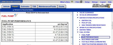

parts that iv'e replaced fuel pump tps switch temp head senor map sens sparks plugs,car starts and runs fine when the car starts to warn up it starts to fall apart and dies won"t reastart also the tack was acken crazy and then quit sounds like it wants to start but don"t checked spark at plugs looked like white spark.thats my story.prr320@aol

Hi prr320@aol.com, Welcome to 2carpros and TY for the donation Let's check the fuel pressure with a gauge if its within specs verify your VIN with the pressures below and get back with the readings. Also check if the injectors are pulsing.

Dear Bob/KEN. I forgouth to tell you a mouse eat throught one of the injector wires,wihich killed cylined #6,Have check fuel pressure 46# injectors, plus ok,3.58 ps think mouse was the culpit.
