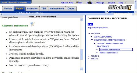

My service engine soon light come on after driving aprox. 50 miles. The light stay off when engin is shut down until I drive aprox. another 50 miles. No code is in computer. What could be the Problem?

Lets try computer relearning for a start follow below to the T.
https://images.2carpros.com/forum/automotive_pictures/12900_comp_2.jpg
