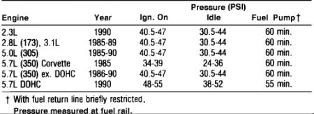

Engine Performance problem
1986 Chevy Corvette V8 Two Wheel Drive Automatic
fuel pressure
Oct 24, 2010 at 1:24 AM
  • 75,992 POSTS
https://images.2carpros.com/forum/automotive_pictures/12900_fpreading_1.jpg
