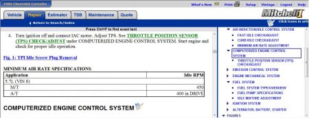

What is the proper idle speed while in park and in drive?
Having trouble keeping it above 500 rpm in drive, but when in park it is at 1100 to 1500.

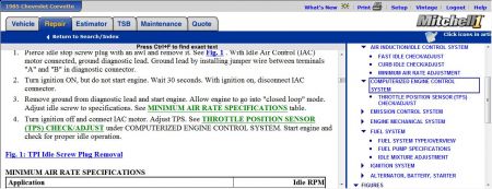

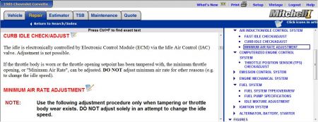

Do below to adjust the curb idle
https://images.2carpros.com/forum/automotive_pictures/12900_idle_speed_4.jpg
https://images.2carpros.com/forum/automotive_pictures/12900_idle_speed_1_2.jpg
https://images.2carpros.com/forum/automotive_pictures/12900_idle_speed_2_1.jpg
