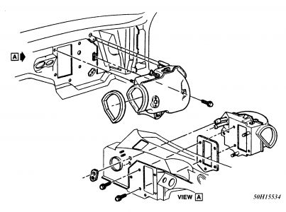

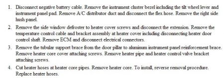

Step by step instruction for replacing the heater core in my 1985 corvette

-1
Friday, April 24th, 2009 AT 1:21 PM
