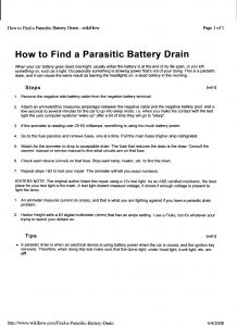

I have a parasetic drain on my battery.It usually takes 24 to 36 hours to drain it.How can I find it?
Apr 25, 2008 at 6:24 PM
  • 75,992 POSTS
How to check for a parastic drain see below
https://images.2carpros.com/forum/automotive_pictures/12900_Parastic_Drain_1.jpg
