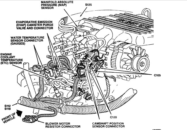

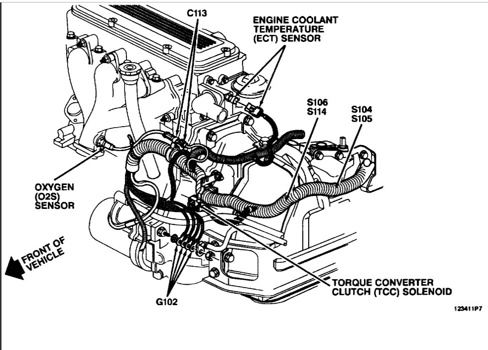

You have an engine coolant temperature sensor that sounds like is not working right. Here is a guide to show you what you are in for when doing the job.
https://www.2carpros.com/articles/coolant-temperature-sensor-cts-replacement
Here is the location for your car both 4 and 6 cylinder engine.
