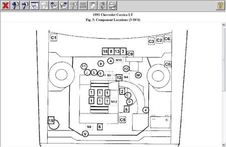

I have a 91 corsica, with a 3.1l 6cy. The heater blower does not come on, have replaced the blower motor but still don't have it working, what next?
Oct 27, 2007 at 4:31 PM
  • 75,992 POSTS
The blower resistor pack, then the control switch
Oct 27, 2007 at 4:45 PM
TRACE65
ok, where is the blower resistor pack at?
Oct 27, 2007 at 5:13 PM
  • 75,992 POSTS
Its on the left side of the blower housing and also the AC/heater blower relay at no.18 see below
