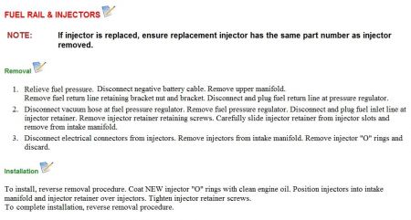

there is any special way to install the fuel injectors like one way o any mark to follow

https://images.2carpros.com/forum/automotive_pictures/261618_Noname_2530.jpg
