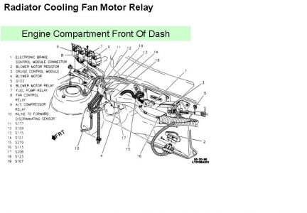

Engine fan shorts out. Causes fuse to blow. Straight wired fan to battery. Fuse blows everytime. Replaced fuse. Car still will not operate. Hooked wire up that was used on the fan, and the car will start. I need a wiring diagram to trace down my problems. Leading to the fuse boxes under the hood, and also the ones on the inside of the car,on the driver's side of the car.
I'm wanting to know was this a recall situation on the problem with this type of vehicle.

Didn't see any technical service bulletins or recalls for this. If I understand you right you said you went right from the fan motor to the battery and the fuse blew. Wouldn't that be an indication that the motor was bad and possible shorting out internally? Fan motor at Auto Zone about $37.00. Have you also looked at the wire very close to ensure it doesn't have a bare spot touching something? I believe there is a protective shield around several wires that needs to be peeled back and ever inch really looked at. What about the fan relay.
https://images.2carpros.com/forum/automotive_pictures/248015_Fan_Relay_2.jpg
