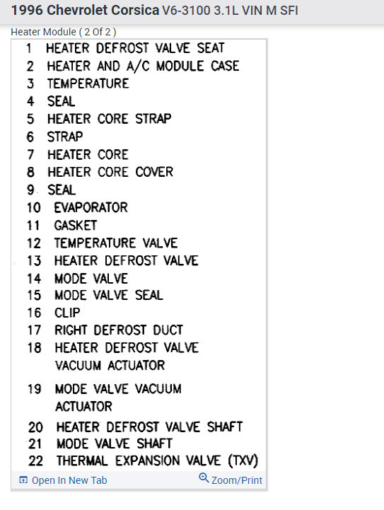

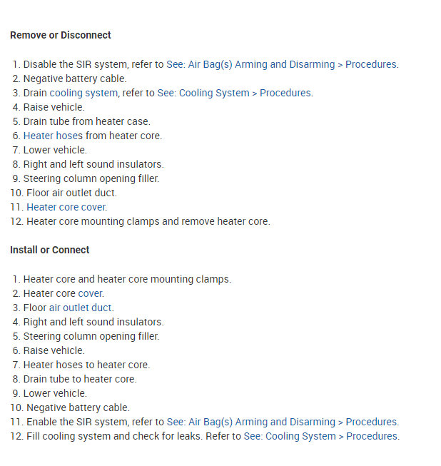

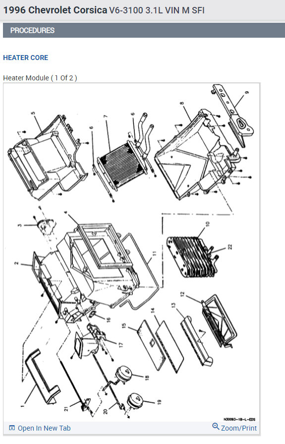

Coolant leak by the firewall typically points to the heater core or the hoses to the heater core might be leaking.
Many times the heater hoses that goes to the core, comes loose or crack over time, causing the leak.
If you can upload a picture of the hose and the location, it will be helpful.
You might find these articles helpful:
https://www.2carpros.com/articles/replace-heater-core
https://www.2carpros.com/articles/replace-heater-hoses
