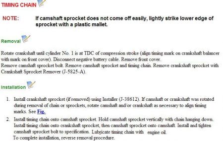

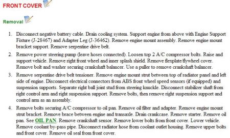

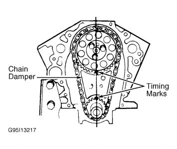

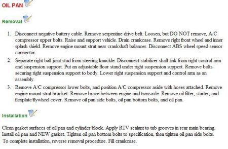

I am a heavy equipment mechanic so I know my way around engines, however, my sons car needs a new timing belt or chain, whatever it takes. I was wondering if you could tell me how to change it?
Any specifics you could give me would help. I am short funds so I do not want to buy a guide. Thanks!

Feb 12, 2010 at 3:15 PM
