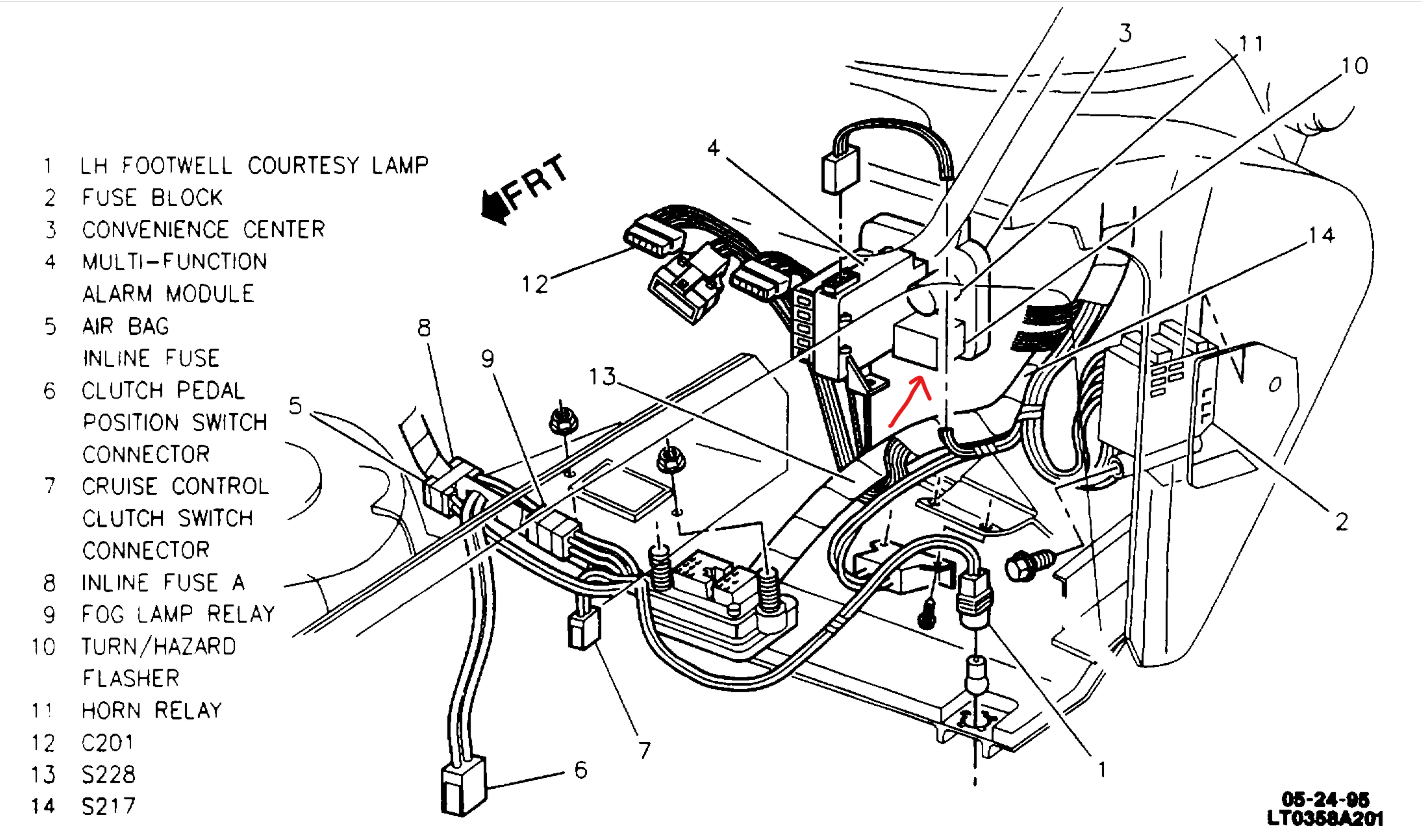

Why do my left turn signal flash fast and my right side flash normal?

Because either you have a faulty flasher unit or one of the bulbs are bad or going bad

I agree with MIKEMOO, I would check the bulbs first and if they are okay replace the turn signal flasher, here is the location in case you need it. This guide can help as well
https://www.2carpros.com/articles/turn-signals-blink-rapidly
Check out the images (below). Let us know if you need anything else.
