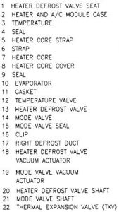

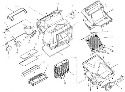

1996 Chevy Corsica V6 Two Wheel Drive Automatic 200000 miles
I need to know how to take a heater core out?
Tuesday, December 4th, 2007 AT 7:22 PM
MIKEMOO
  • 7 POSTS
Properly disable the SIR system, as outlined earlier in this section.
Disconnect the negative battery cable.
Drain the cooling system into a suitable container.
Raise and safely support the vehicle.
Disconnect the drain tube from the heater case.
Detach the heater hoses from the heater core.
Carefully lower the vehicle.
Remove the right and left sound insulators.
Remove the steering column opening filler.
Remove the floor air outlet duct.
Remove the heater core cover.
Unfasten the heater core mounting clamps, then remove the heater core from the vehicle.
