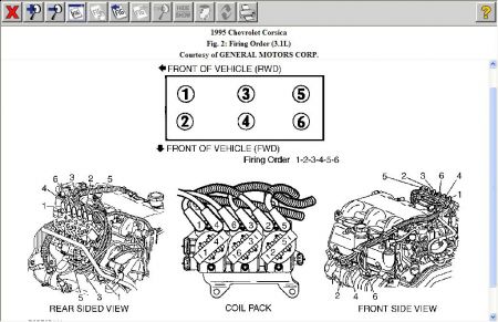

1995 Chevy Corsica sparkplug wiring diagram
1995 CHEVROLET CORSICA
69,000 MILES • 6 CYL • FWD • AUTOMATIC
STEVEMCDREED
what is the spark plug wiring order at the ignition coils? i know what the firing order is, but need to know which spark plug wire goes to which coil terminal as the numbers have worn off through the years. thank for your help

https://images.2carpros.com/forum/automotive_pictures/12900_fo_40.jpg
