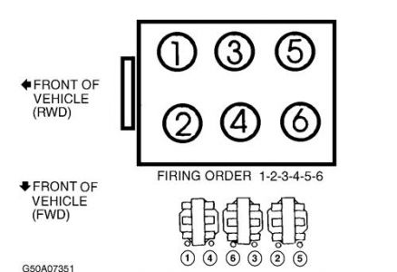

1994 Chevy Corsica spark plugs
1994 CHEVROLET CORSICA
110,000 MILES • 6 CYL • FWD • AUTOMATIC
JOSHTHEOX
i had to change spark plugs, wires and the distributors and i did it in a hurry without remembering which plugs go to which caps. So i need to know what the cylinders are numbered so i can connect to sparkplugs to the distributors. help appreciated.i know the distributors go 523641 just need to know is they go to the right sparkplugs

https://images.2carpros.com/forum/automotive_pictures/12900_fo_109.jpg
