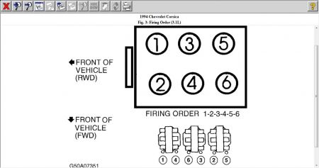

i need the right firing order

There you go and Merry Christmas
https://images.2carpros.com/forum/automotive_pictures/12900_fo_78.jpg
