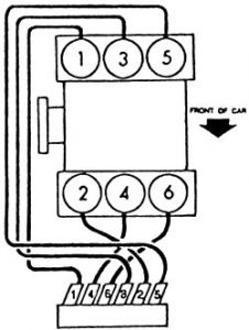

Please help me find the correct wiring order for the spark plug wires in a 94 corsica 3.1

Fig. 3: 2.8L and 3.1L engines ?nl?> Firing order:1-2-3-4-5-6?nl?> Distributorless Ignition System
