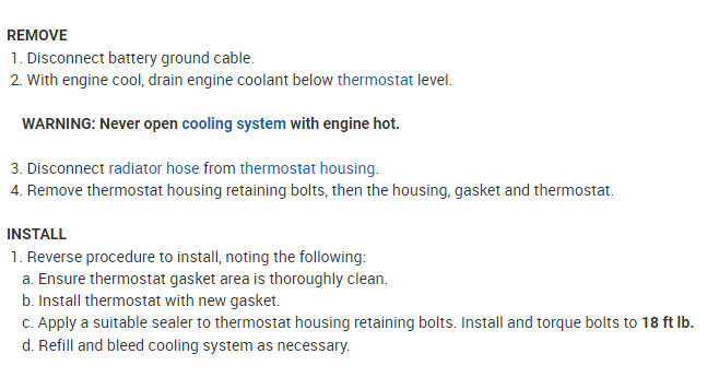

How do you repalce the thermostat in your car?
Aug 11, 2008 at 7:24 PM
SQM
  • 6,383 POSTS

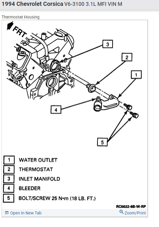

Thermostat replacement on your vehicle can be done using simple hand tools.
Before you get started make sure that the engine is cool. That way you don't have to worry about hot coolant being a hazard.
The thermostat is inside the thermostat housing, which is installed by 2 screws.
You will find this article helpful:
https://www.2carpros.com/articles/how-an-engine-thermostat-works
I have attached thermostat replacement procedure for your reference.
