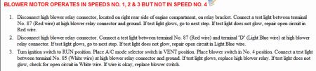

When I try to use the MAX setting on the selector switch, there is no difference between MAX and NORM. The a/c works fine, as does the heater, just no MAX performance.

https://images.2carpros.com/forum/automotive_pictures/62217_High_Blower_1.jpg
