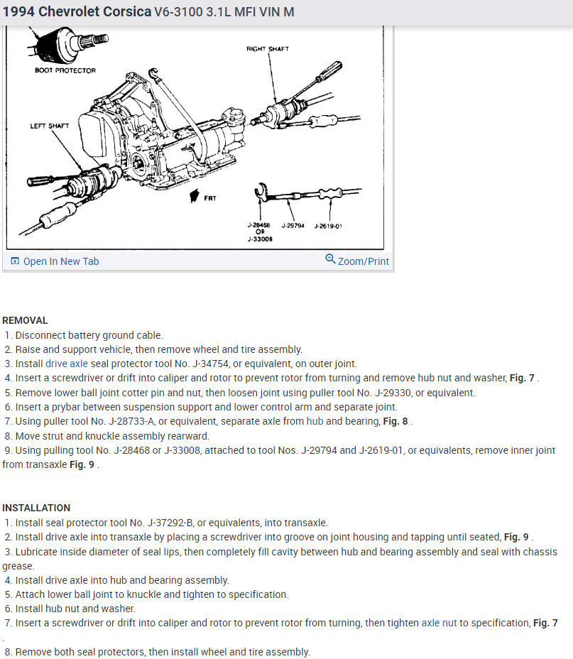

I was wondering how to replace the passenger side cv half shaft. How much more would it cost going to the shop, rather then doing it myself?
Dec 30, 2008 at 1:06 PM
SQM
  • 6,383 POSTS
Replacing a CV axle requires several steps to complete. With the right tools it can be done in one to two hours.
A CV axle can cost between $50.00 and $80.00 (US) at your local parts store.
If you have a shop install the axle it can cost somewhere around $300.00 depending on the shop rate.
Here is a article that might help you decide:
https://www.2carpros.com/articles/replace-cv-axle

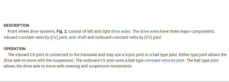

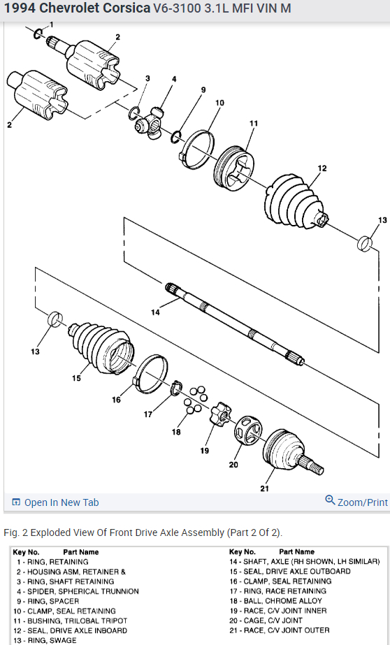

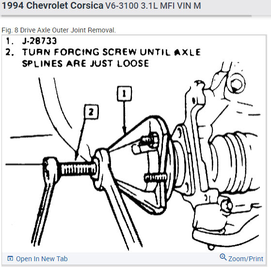

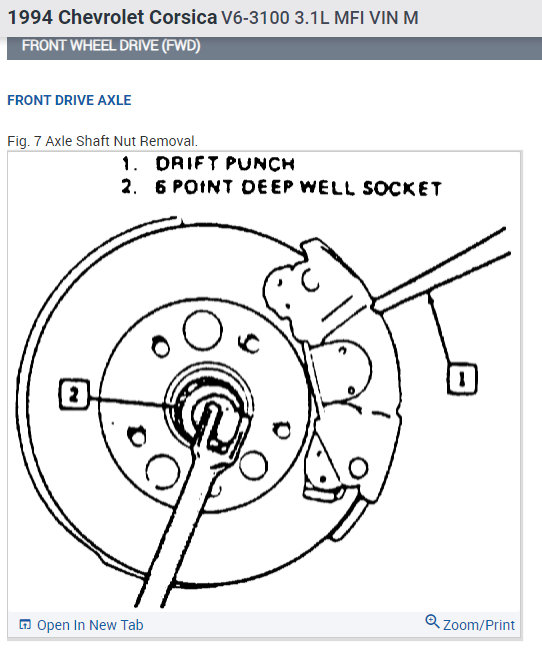

I have also attached replacement procedure for your vehicle.
